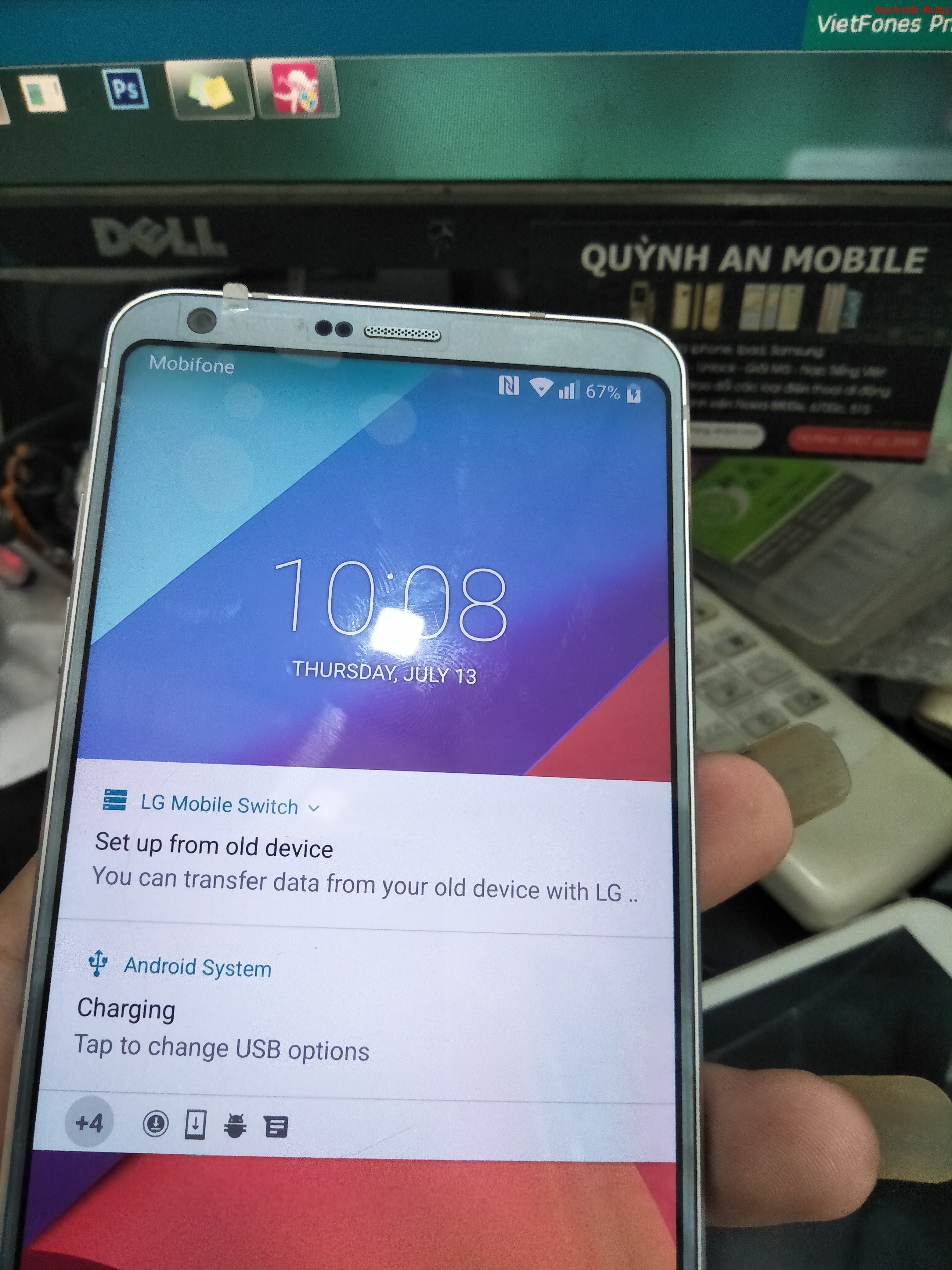

    Mã:
    Welcome to Octoplus/Octopus Box LG Software version 2.6.8
    Checking data...OK
    Platform: LG Qualcomm
    Selected port: COM4
    Selected model: LS993
    Please, put the phone into download mode manually (Power phone OFF, press and hold "Vol+" button and connect the cable).
    Reading info...
    Initializing ADB...OK
    Waiting for phone...
    Please, reconnect phone, enable USB debugging, and try again.
    To enable USB debugging, please perform the following steps:
    1. Disconnect cable
    2. Install LG Android ADB drivers
    3. Go to "Settings" -> "About phone" -> "Software information"
    4. Click on Build number 5 times
    5. Enable "Settings" -> "Developer options" -> "USB debugging" option
    6. Connect the cable and check, whether ADB interface has appeared in PC Device Manager.
    Performed by 2.6.8 Software version.
    Checking data...OK
    Selected port: COM4
    Reading info...
    1. Disconnect cable
    6. Connect the cable and check, whether ADB interface has appeared in PC Device Manager.Canceled!
    Checking data...OK
    Selected port: COM166
    Reading info...
    IMEI: 350305-26-000000-4
    Android version: 7.0
    Battery level: 68%
    SW Version: LS993ZV4
    Mode: Emergency
    Initializing flash...OK
    SW version: LS993ZV5_03
    LAF Version: 1.1
    Product ID: PT02S170412004806
    IMEI: 355140-08-147524-1
    Target operator: SPR
    Hardware: rev_10
    Reading partitions...OK
    Resetting FRP Lock...
    Resetting FRP lock successfully completed!
    Checking data...OK
    Selected port: COM4
    Reading info...
    1. Disconnect cable
    6. Connect the cable and check, whether ADB interface has appeared in PC Device Manager.OK
    Model ID: LG-LS993
    Phone firmware version: LGLS993AT-00-VZV5-SPR-US-APR-12-2017+03
    Kernel version: 3.18.31-perf-ged0cbde-00002-gfa1ea85 (lgmobile@LGEACI6R4) (gcc version 4.9 20150123 (prerelease) (GCC) ) #1 SMP PREEMPT Wed Apr 12 16:23:42 KST 201
    Hardware: Qualcomm Technologies, Inc MSM8996pro AArch64 Processor rev 1 (aarch64)
    Please, type ##3424# to get SPC / MSL / Service Code...Failed!
    Checking data...OK
    Reading info...
    Battery level: 67%
    SW Version: LS993ZV5
    Mode: Normal
    Firmware compiled date: Feb 22 2017
    Firmware compiled time: 18:00:00
    Firmware released date: Apr 12 2017
    Firmware released time: 16:18:32
    SW Version: MPSS.TH.2.0.1.c3.1-00014-M8996FAAAANAZM-1.86009.20
    Bluetooth address: A8:B8:6E:E7:D9:0D
    Wi-Fi MAC address: A8:B8:6E:49:00:0F
    SPC: 923551
    MEID: 35514008147524
    Mobile ESN: 80DCA9FB
    OTKSL: 025862
    NAM Name: Sprint
    User Lock Code: 5083
    Switching to Download mode...OK
    Reading Carrier...OK
    Unlocking...OK
    Writing Carrier...
    LAF Error: 80000121.
    Trying second method...OK
    Phone successfully unlocked!
